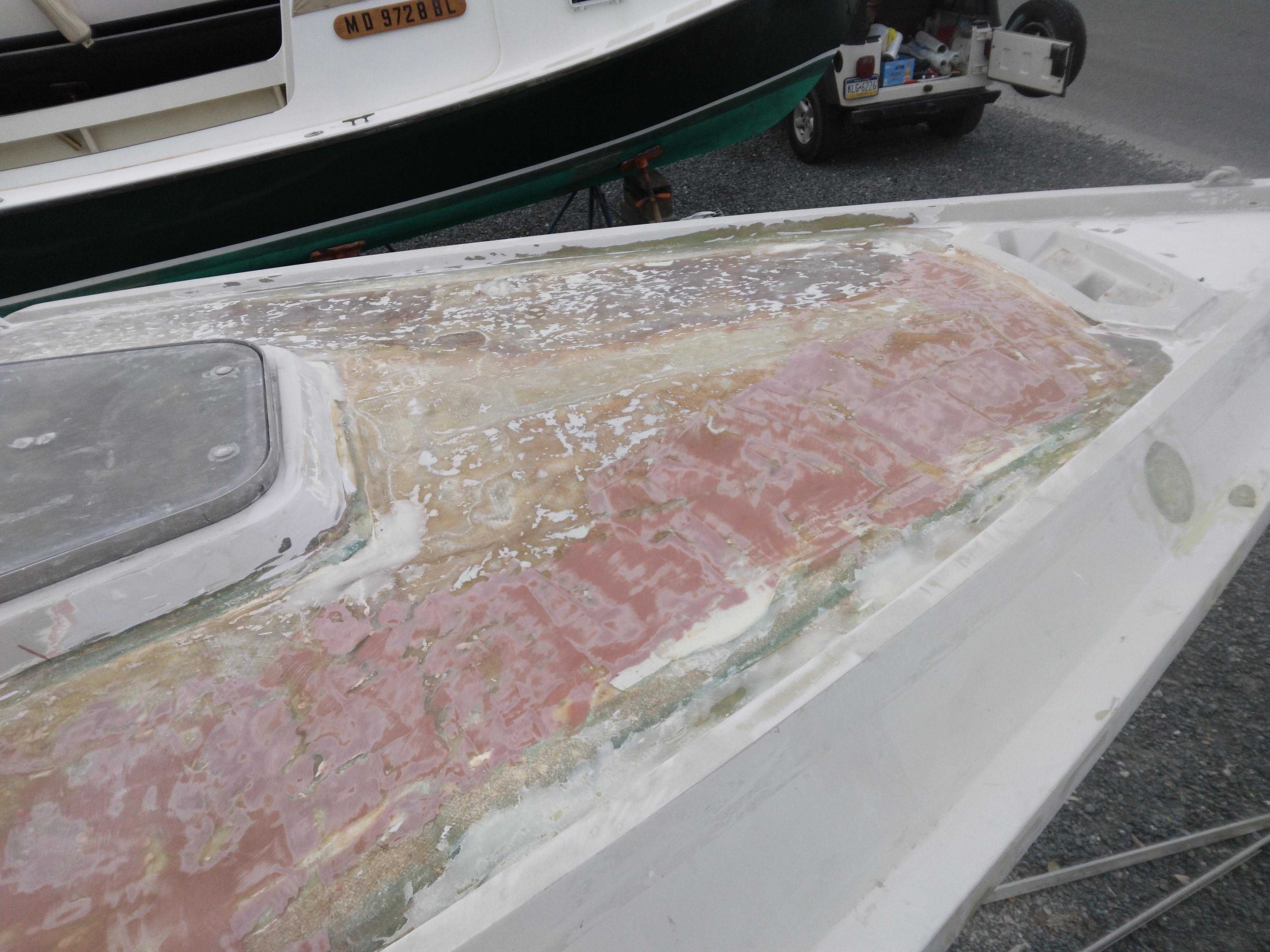

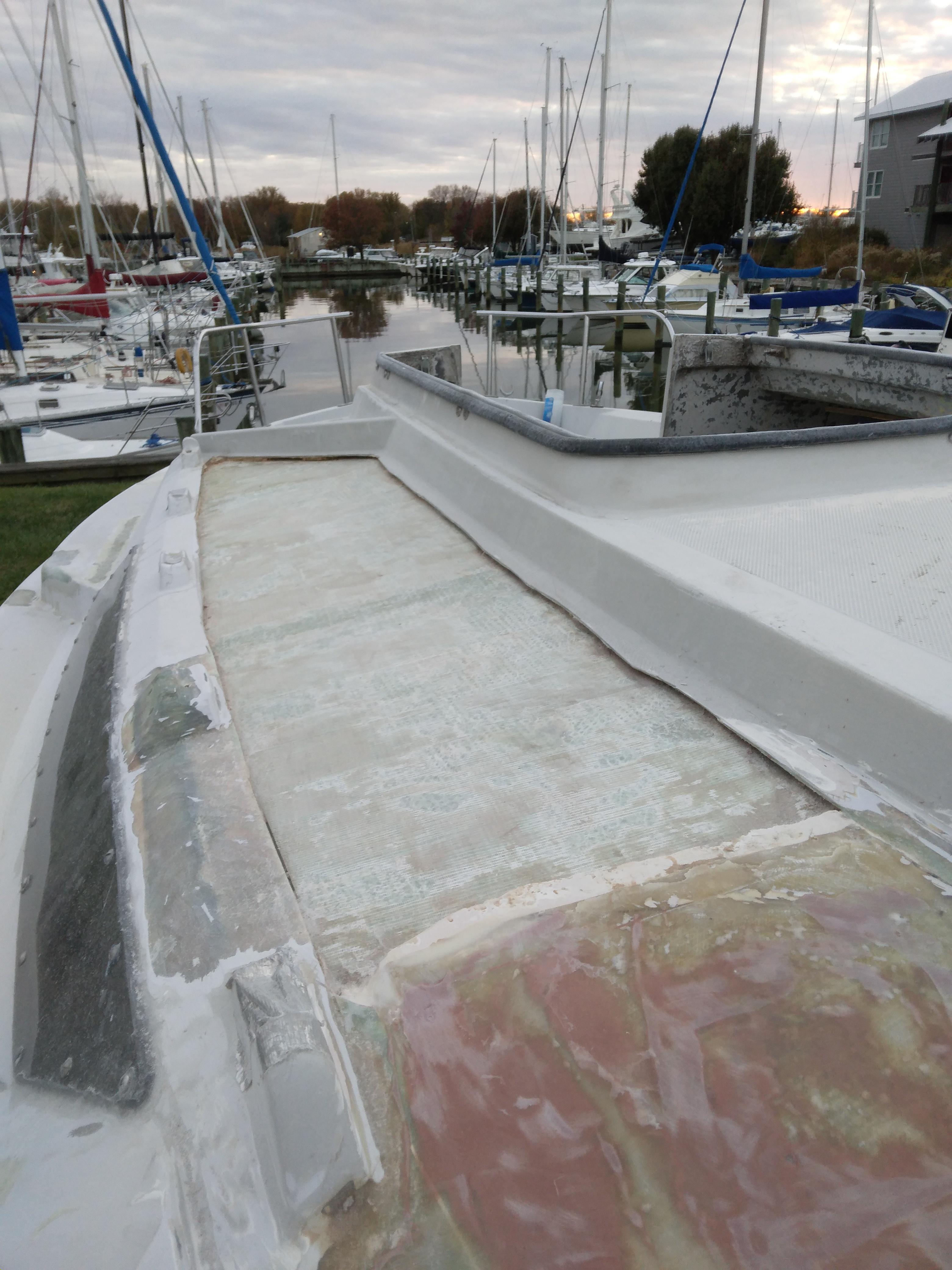

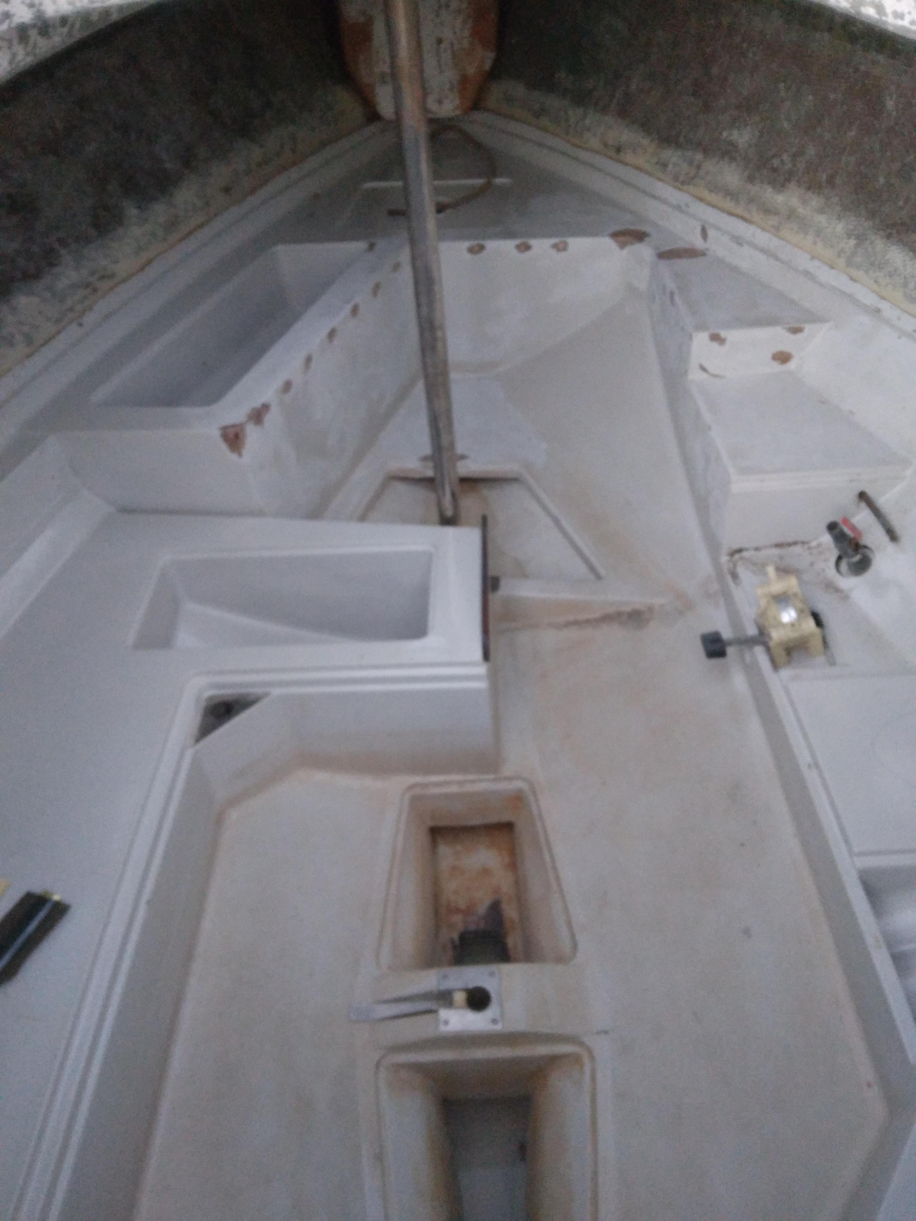

I have created replacement covers using left over balsa core sandwiched to new plywood. the idea was to create strong, light panels, however they turned out to be just as heavy once they were glassed

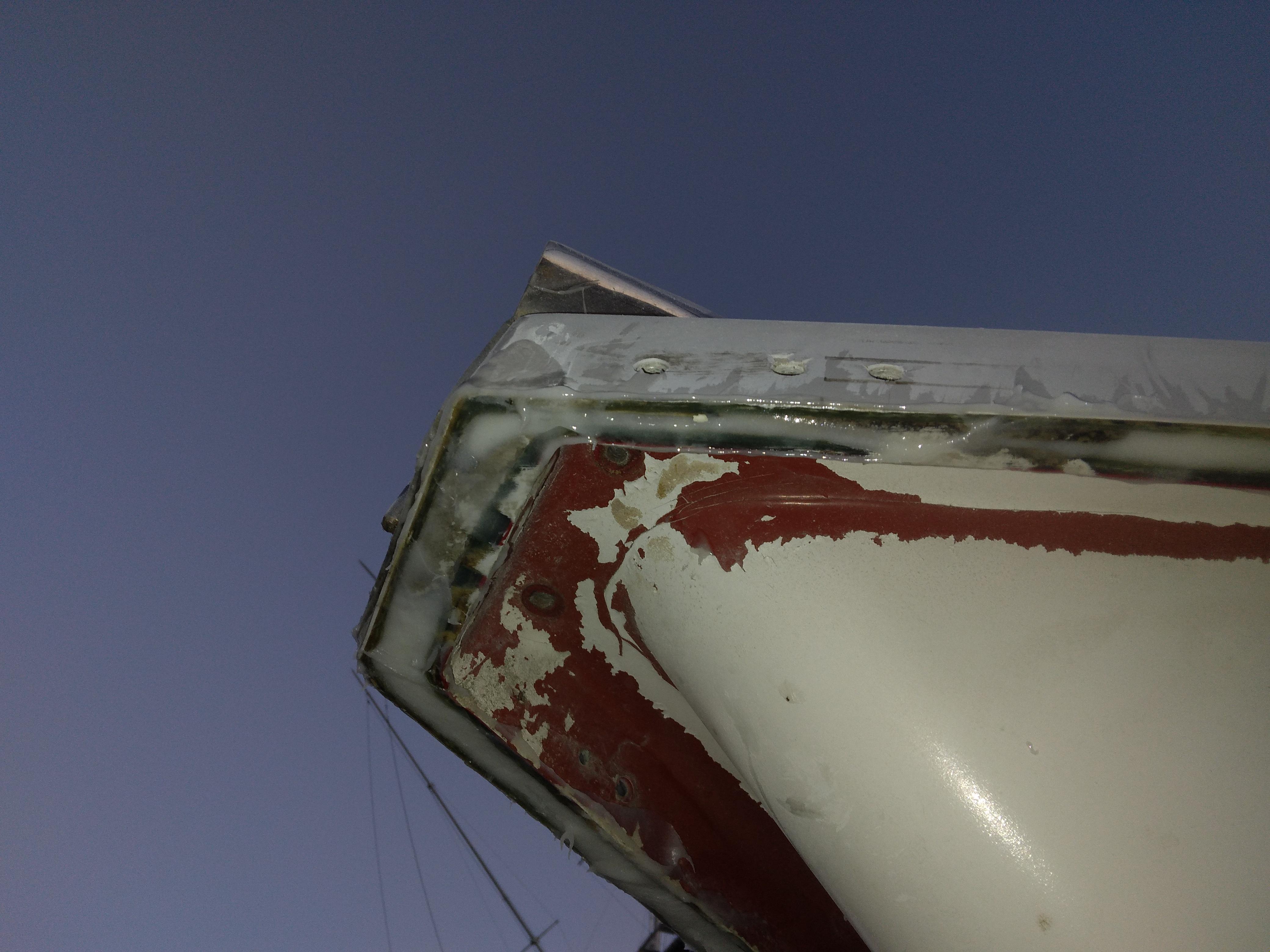

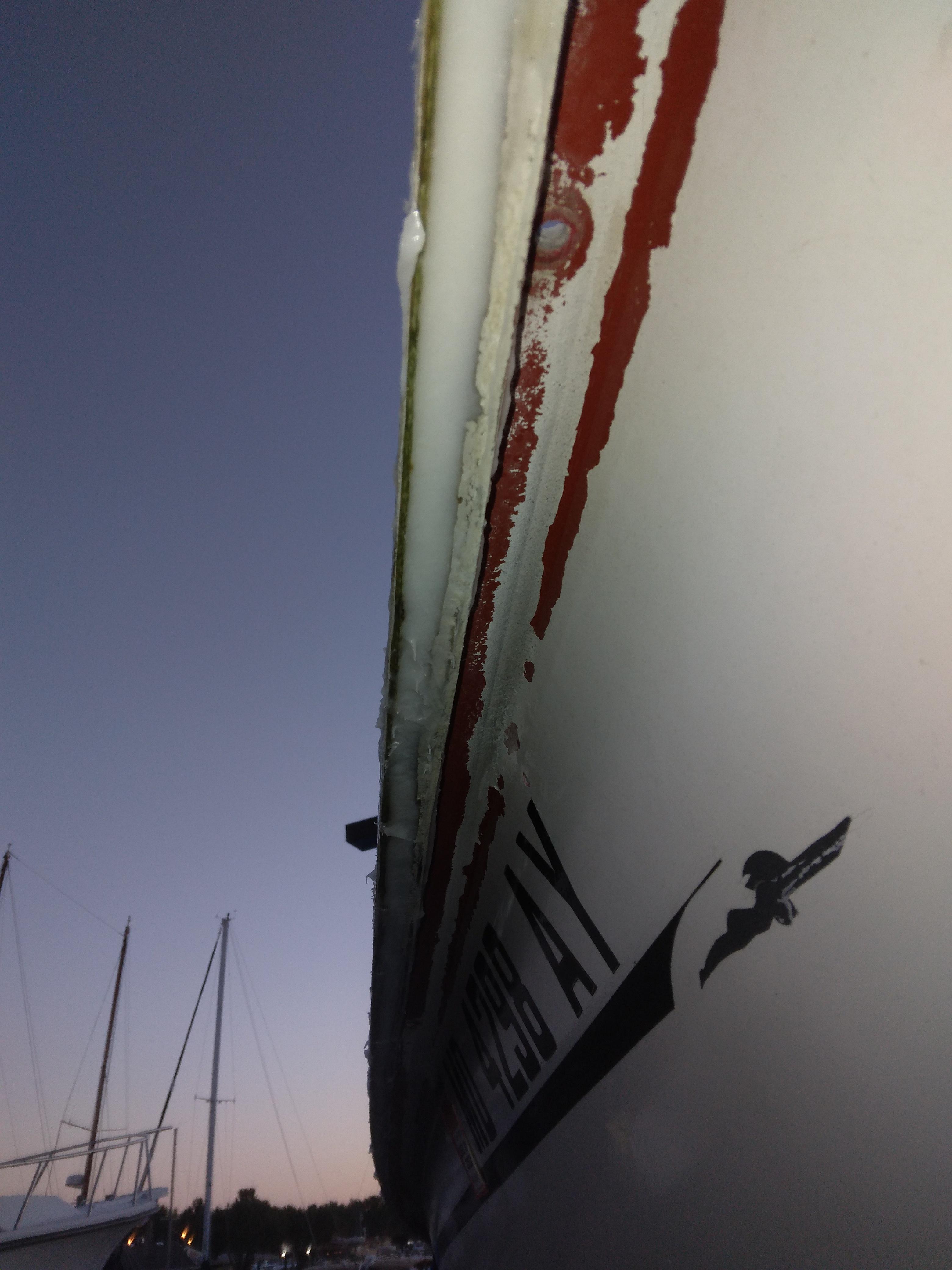

On the outside of the of the hull/ deck joint I removed some of the crumbling adhesive and filled the gap with thickened epoxy the entire way around the boat

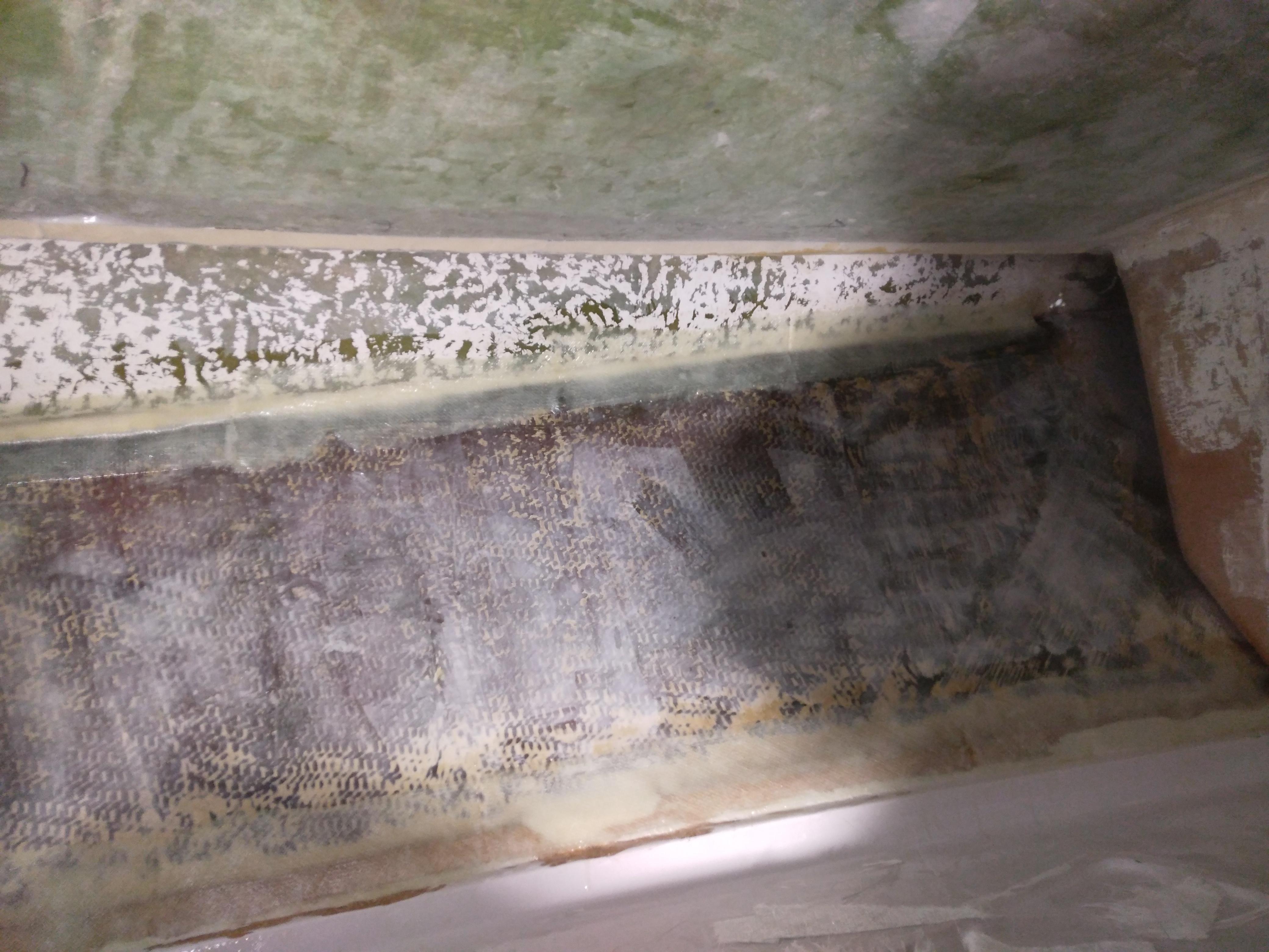

on the inside, i began to reinforce the hull/ deck joint

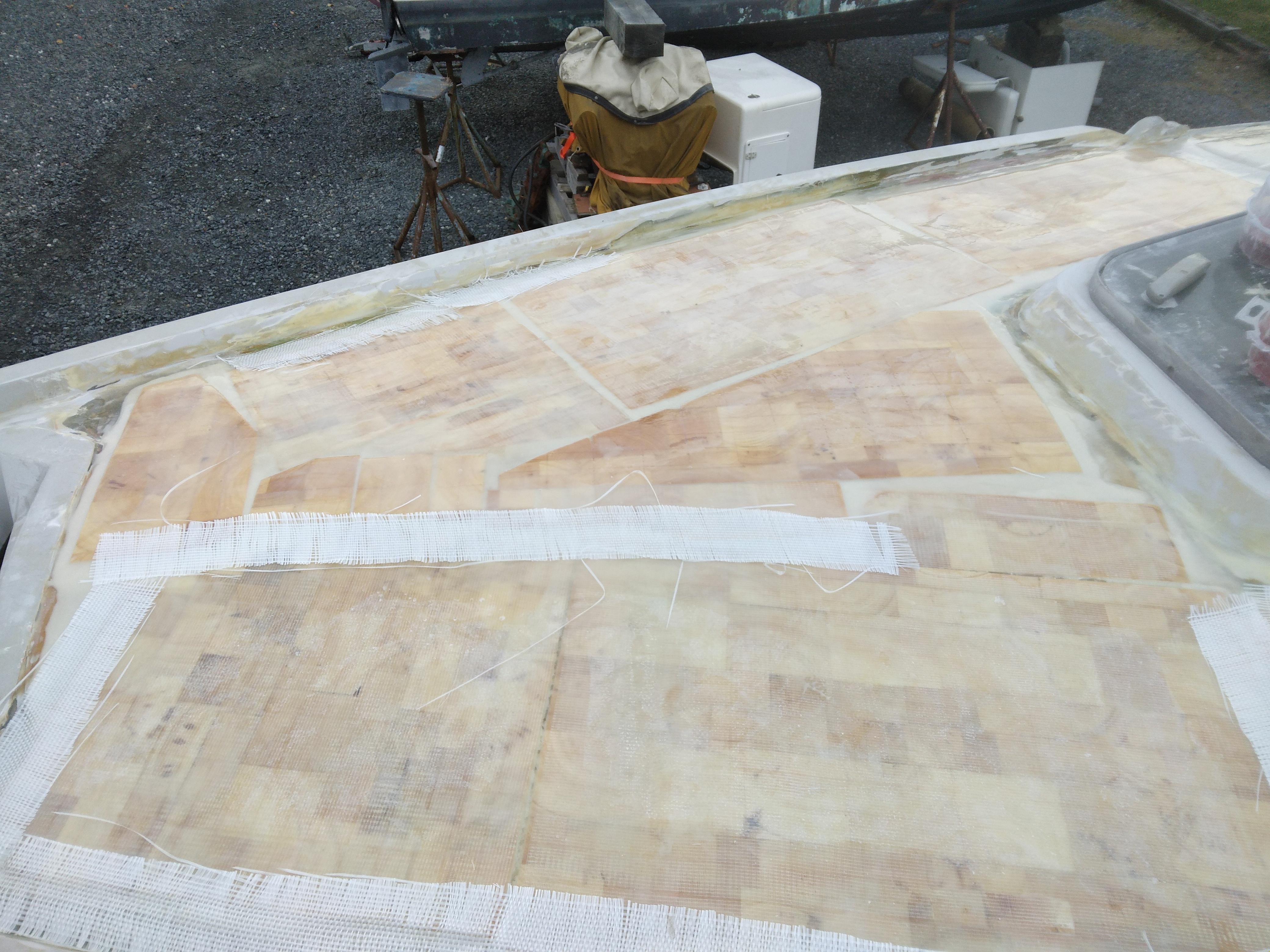

Once the balsa mat was laid up, i covered it all with new glass, and began the process of fairing the deck

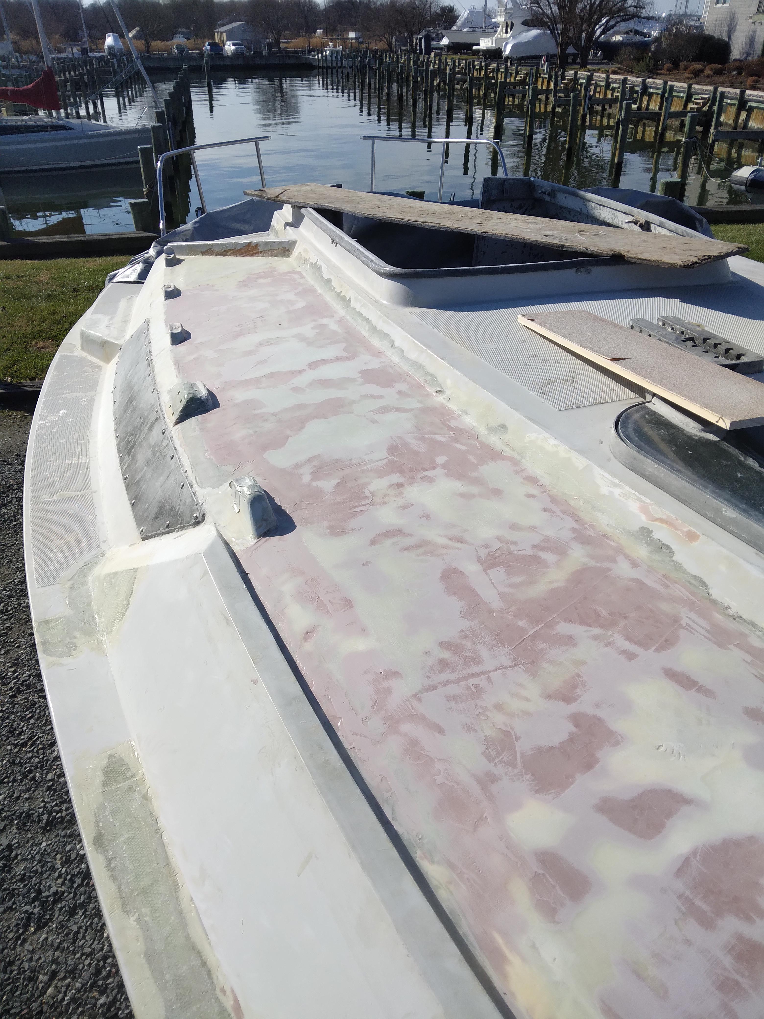

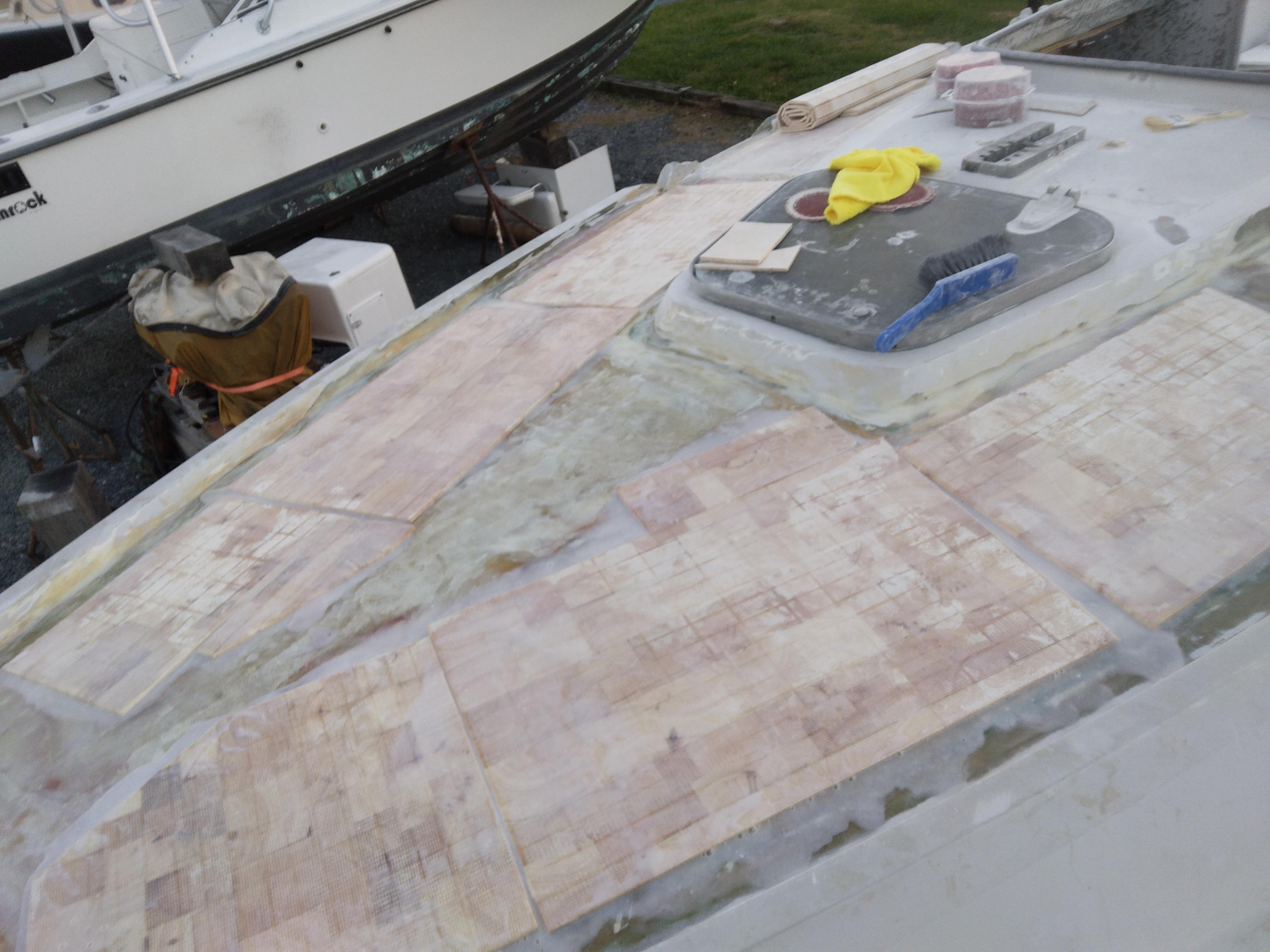

using west systems epoxy products and .25 inch end grain balsa mat, I re-cored the entire deck. As this is my first boat, and I have never attempted anything like this before, it was a large undertaking for me, but the deck is beginning to look better.

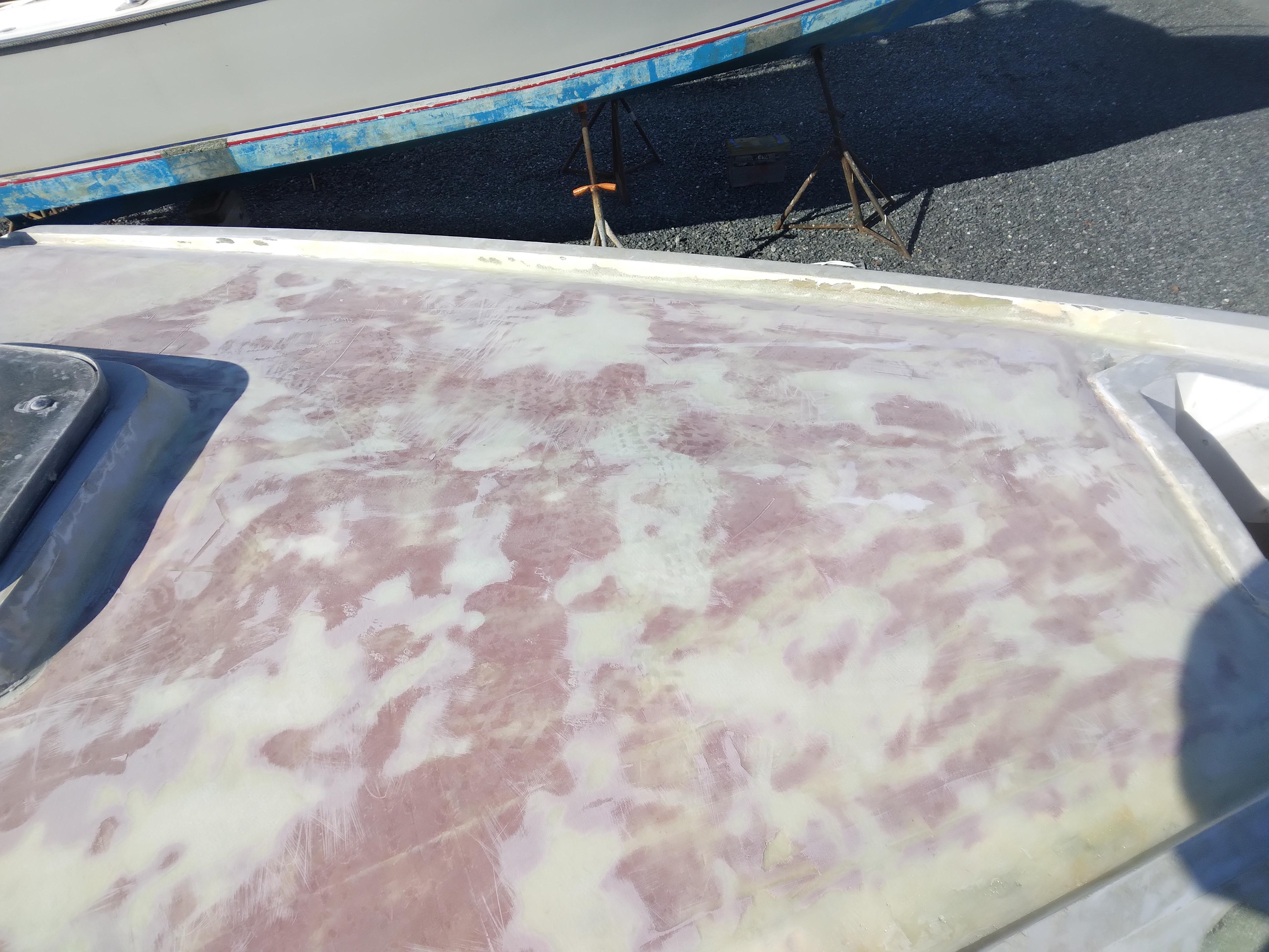

facing aft, I have removed the skin where possible and was able to sand down and reuse portions. Once the old material was removed and sanded down, I began the process of fairing the deck to prepare for recoring
entire deck was delaminated, plus there had been earlier repair attempts prior to my ownership

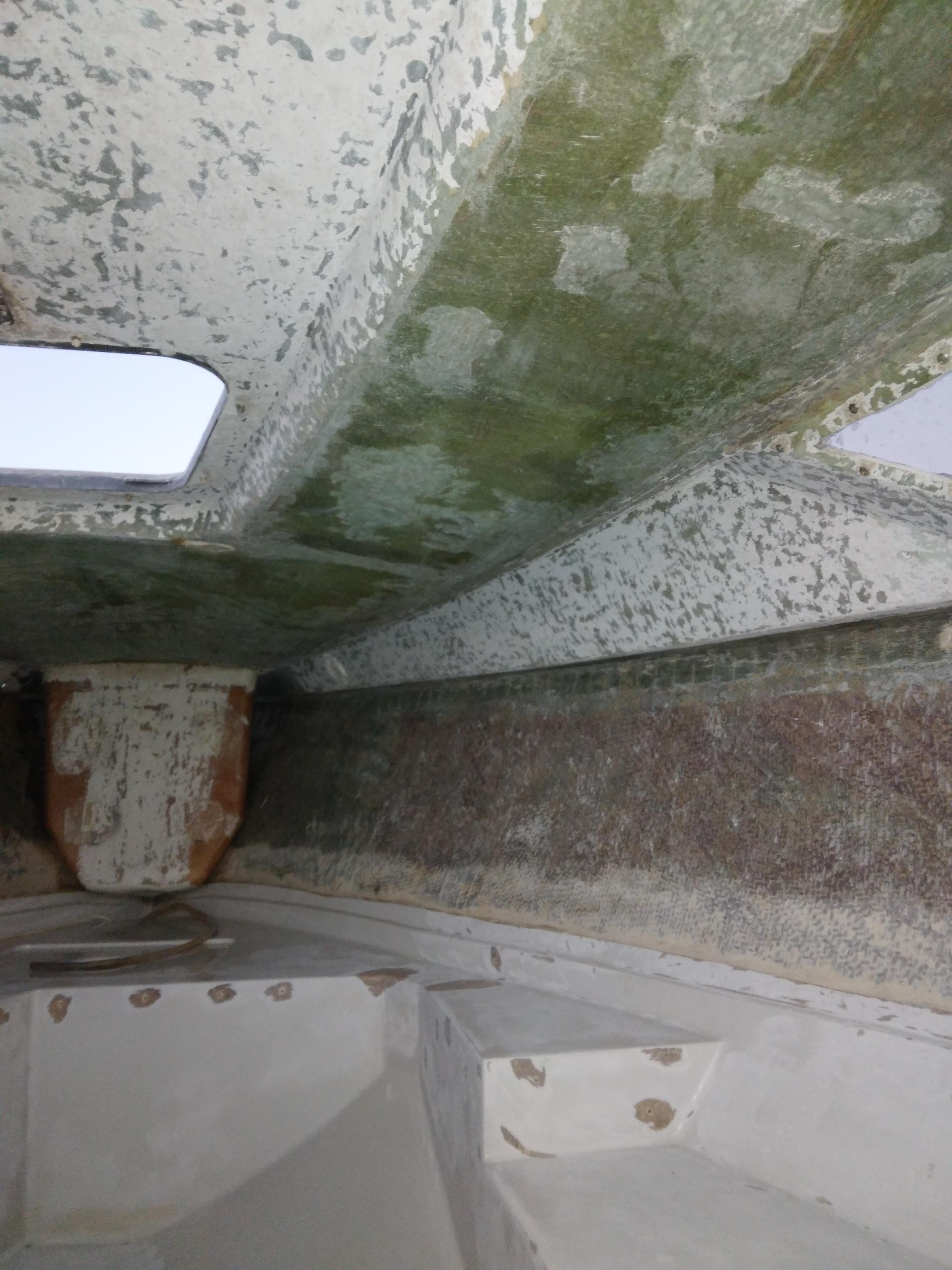

interior sanded down to glass, preparing to rebuild

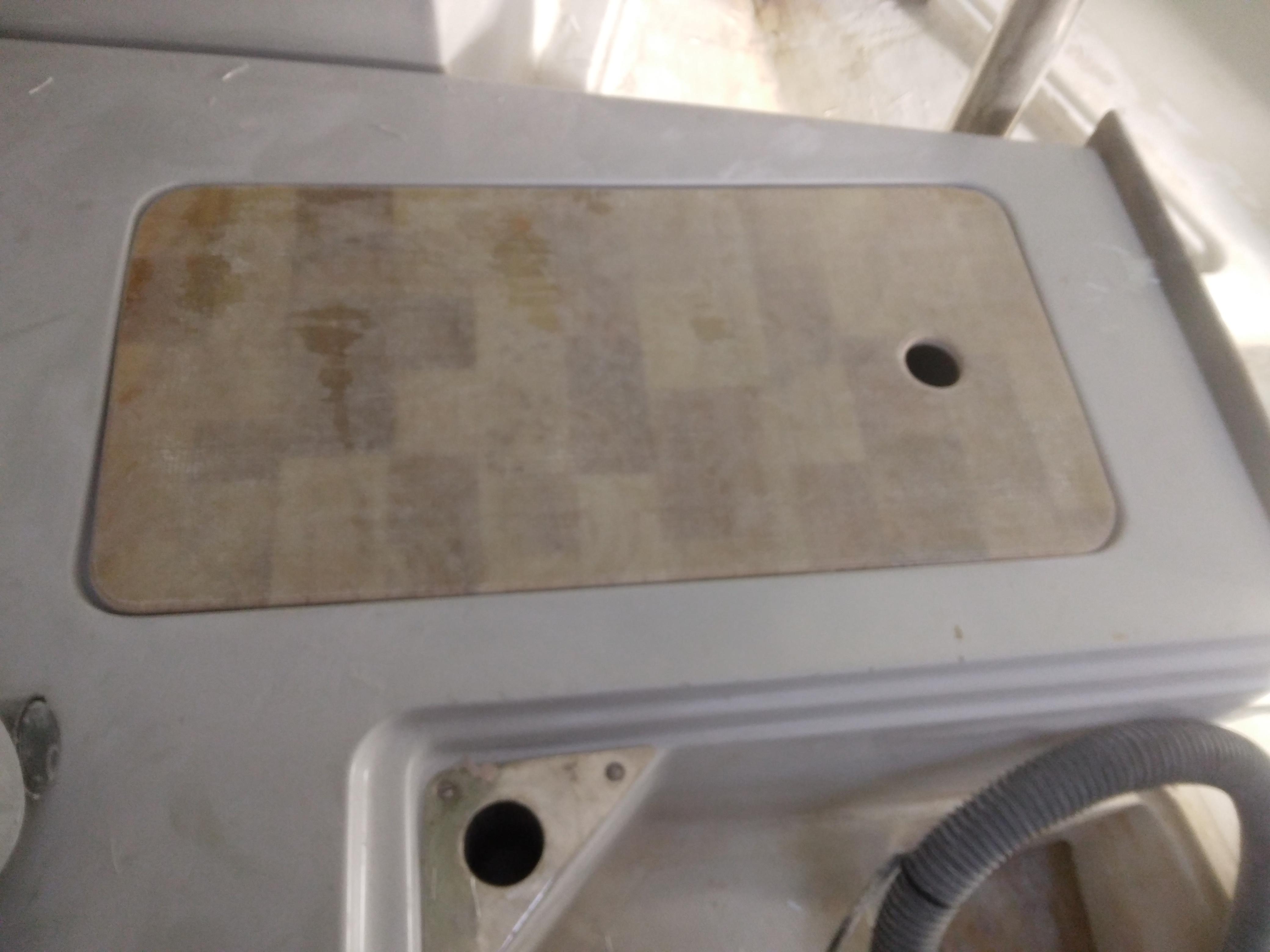

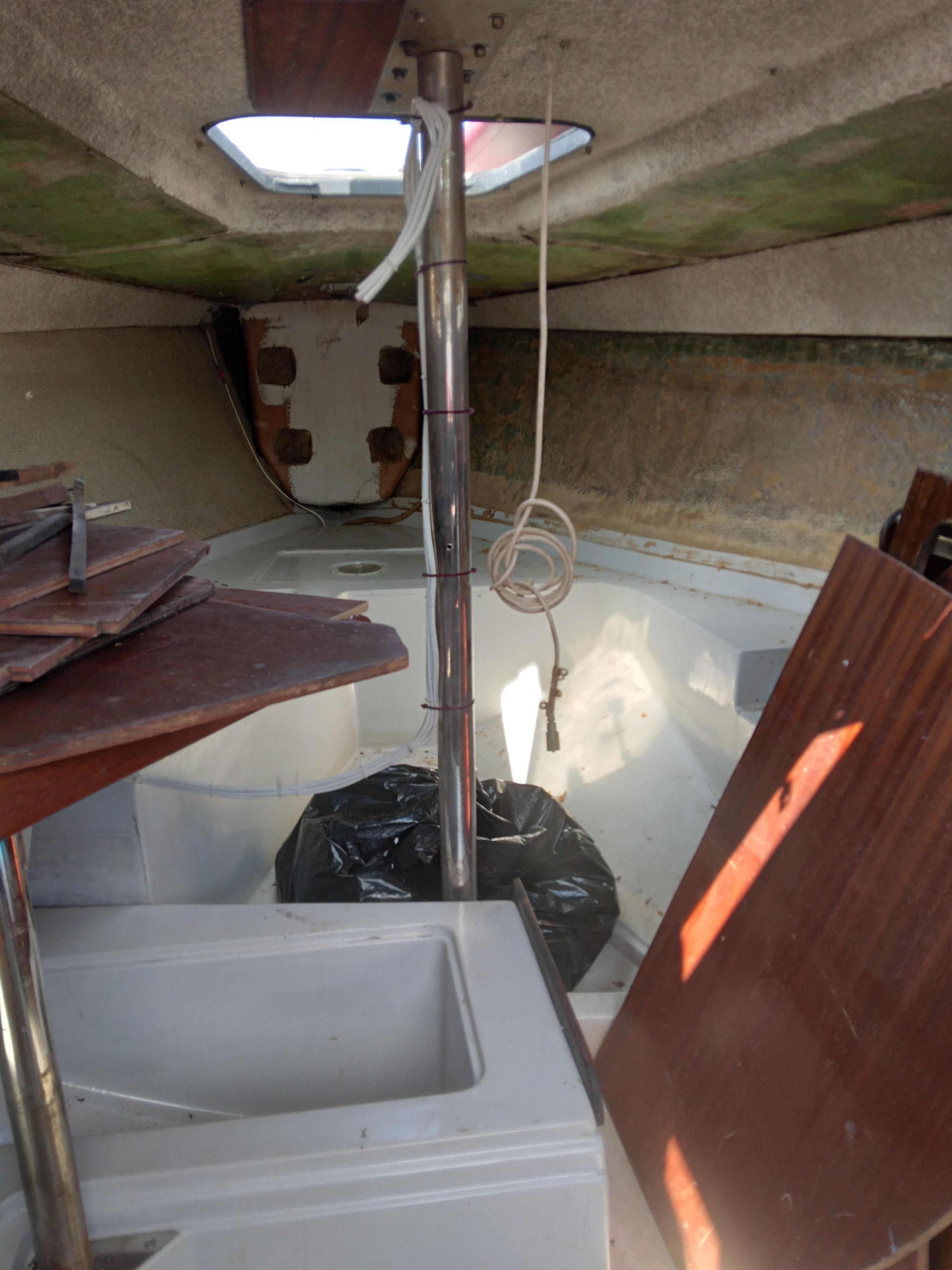

molded cabin floor after removal of interior fittings

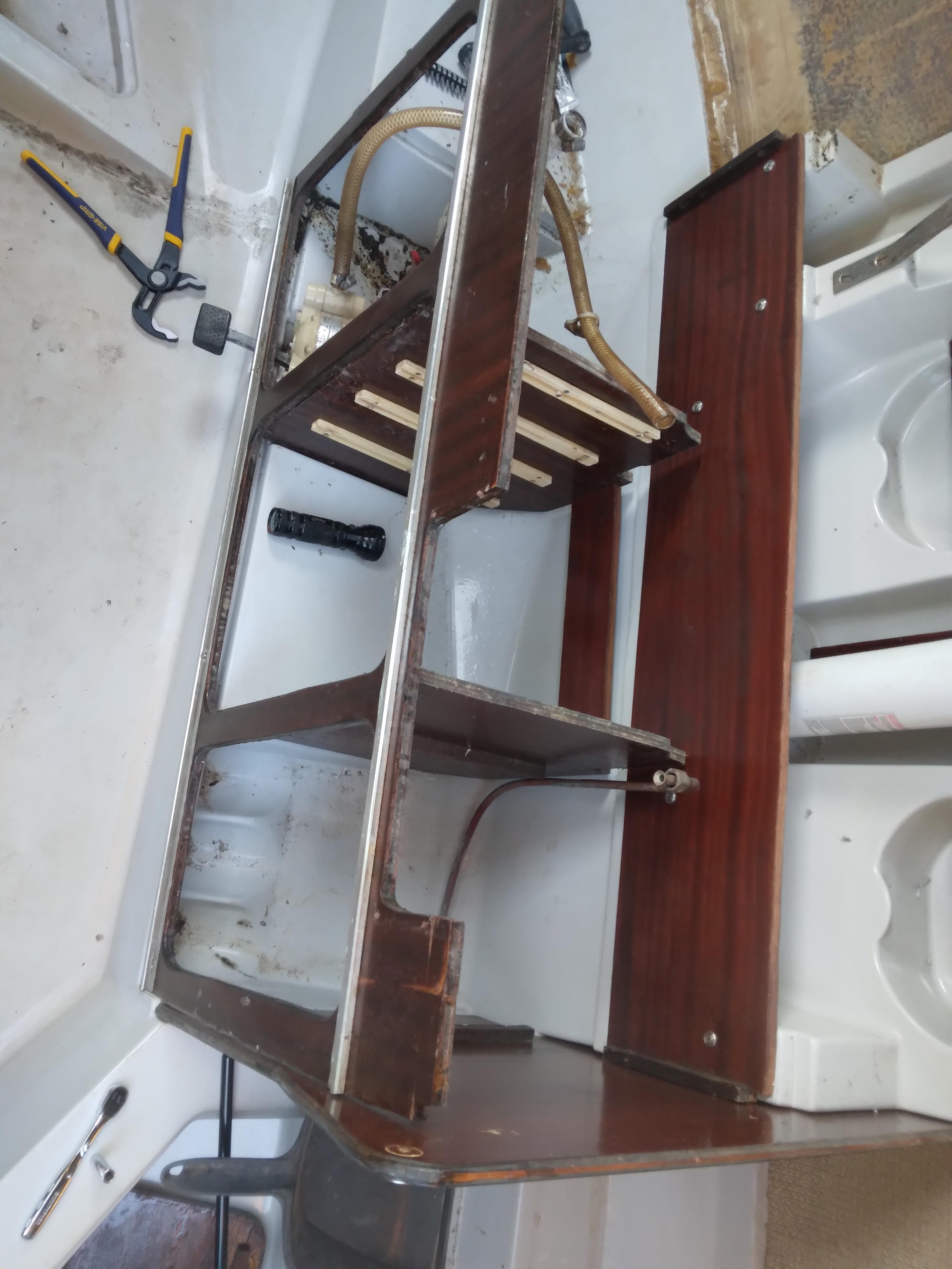

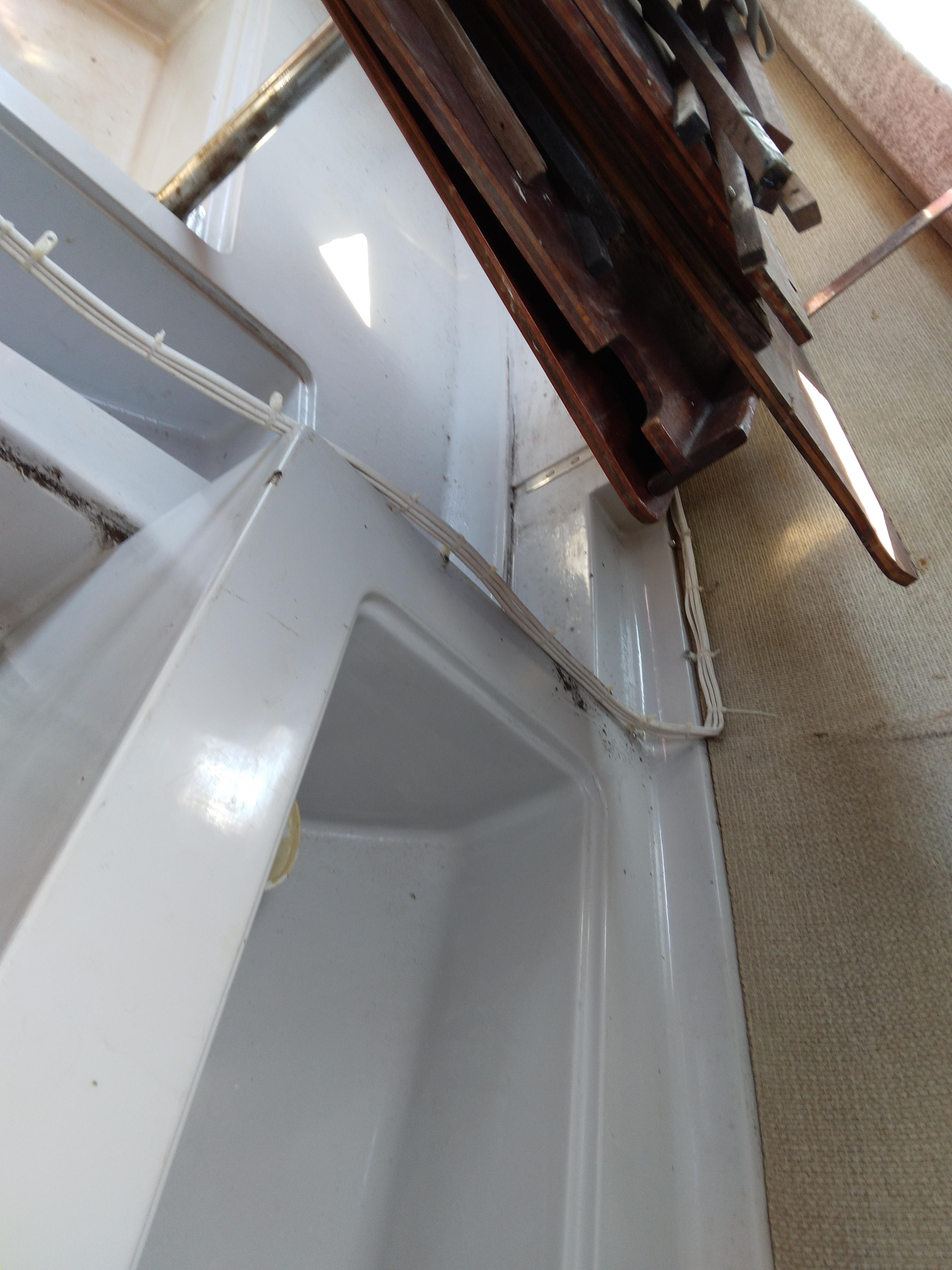

removal of original sink/stovetop

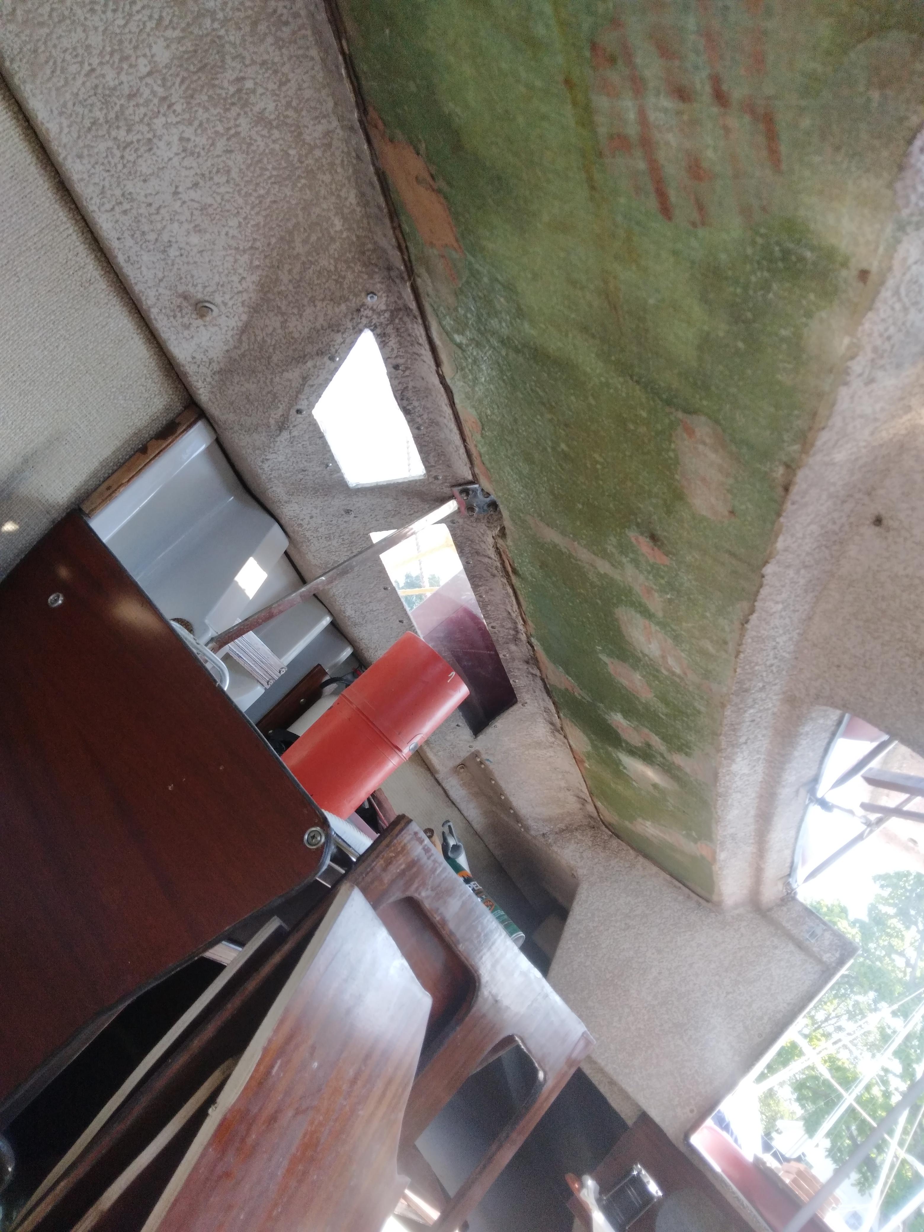

facing towards the bow, cabin roof at time of purchase
port side cabin roof at the time of purchase
before gutting of the hull

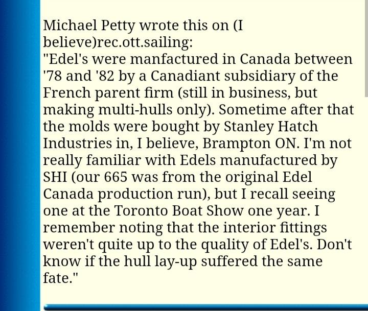

18 février 2022 à 19 h 16 min #30277From what I have been told from the previous owner, this boat was built under the Canadian subsidiary, in 1980. I have seen a handful for sale within the states, but I’m not sure about the numbers of boats actually produced there.

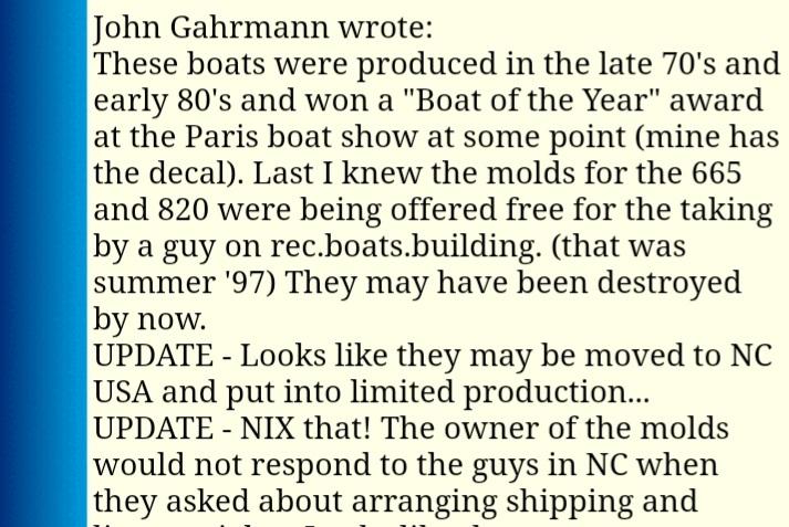

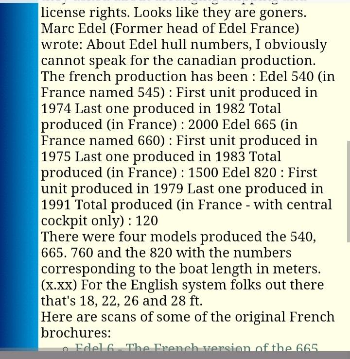

19 février 2022 à 16 h 04 min #30281I found some information regarding the Canadian production group from an older website. I will post the screenshots.
19 février 2022 à 16 h 05 min #30282
19 février 2022 à 16 h 05 min #30283
