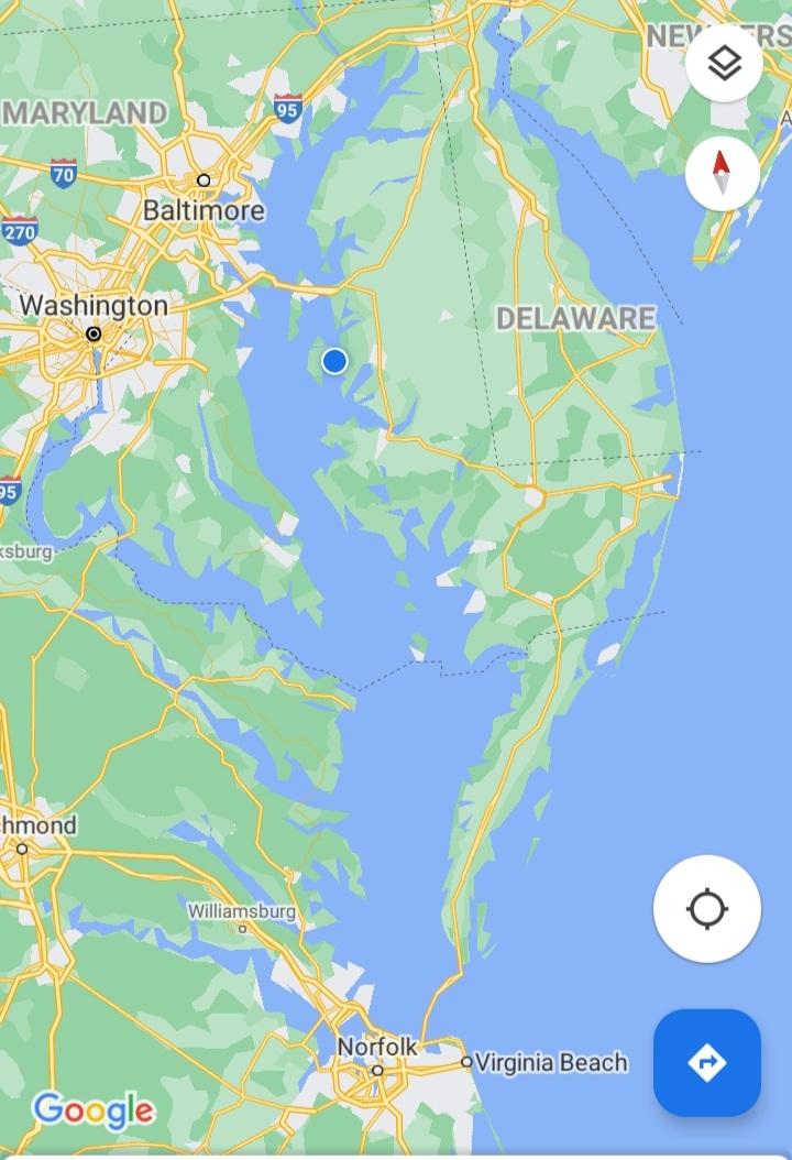

<p style= »text-align: left; »>The blue dot in the screen shot represents the location of the pictures taken above.

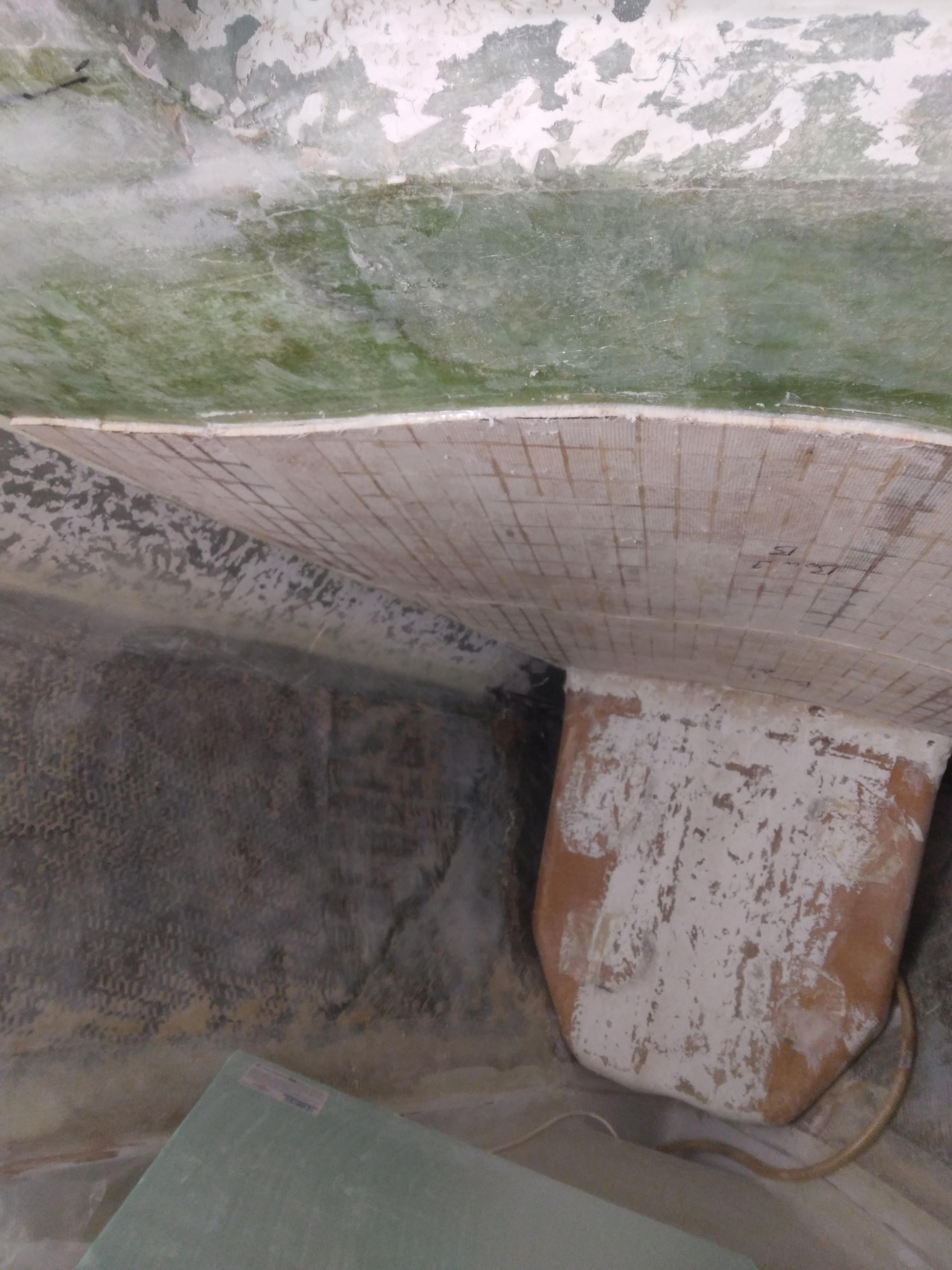

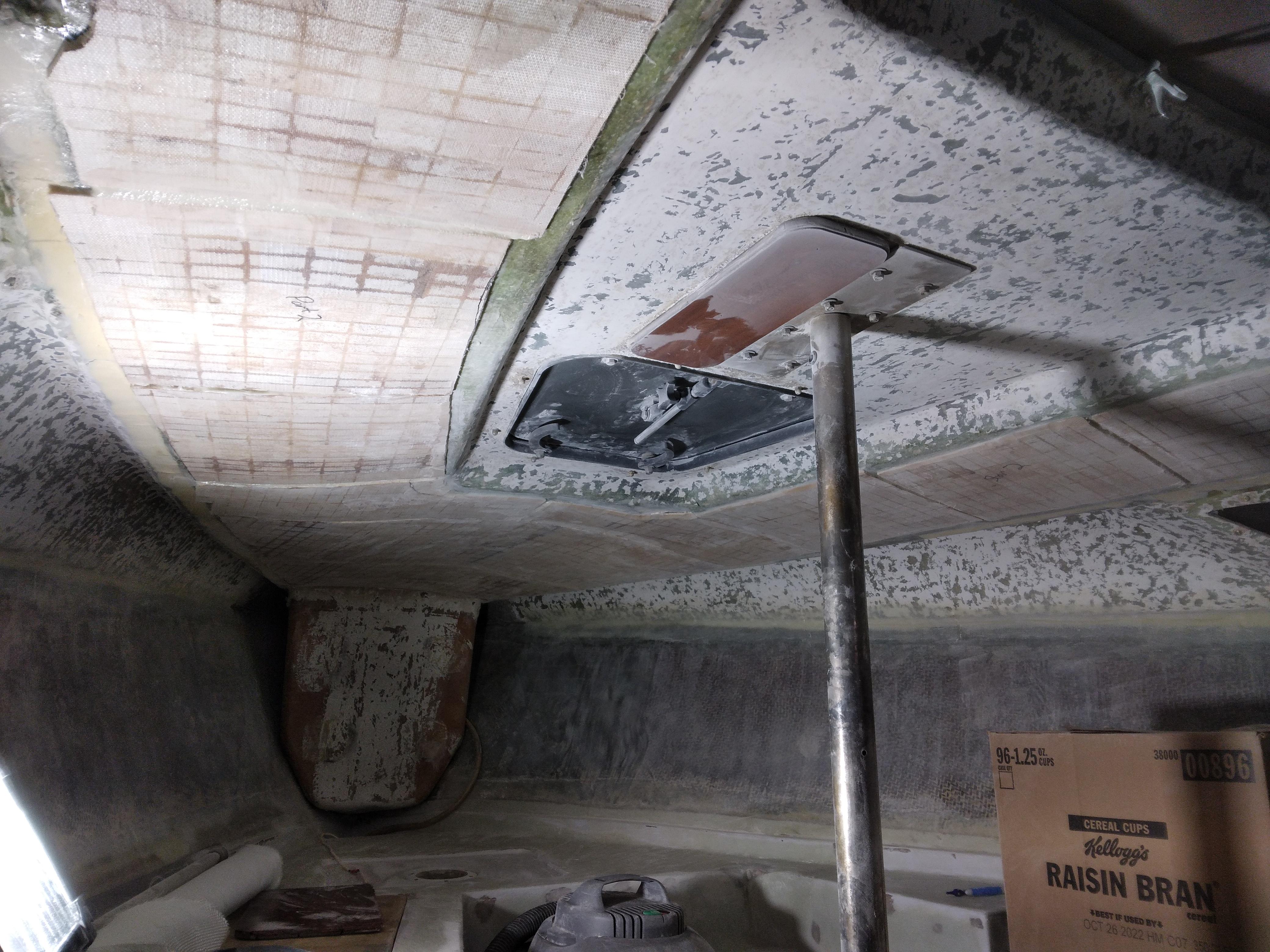

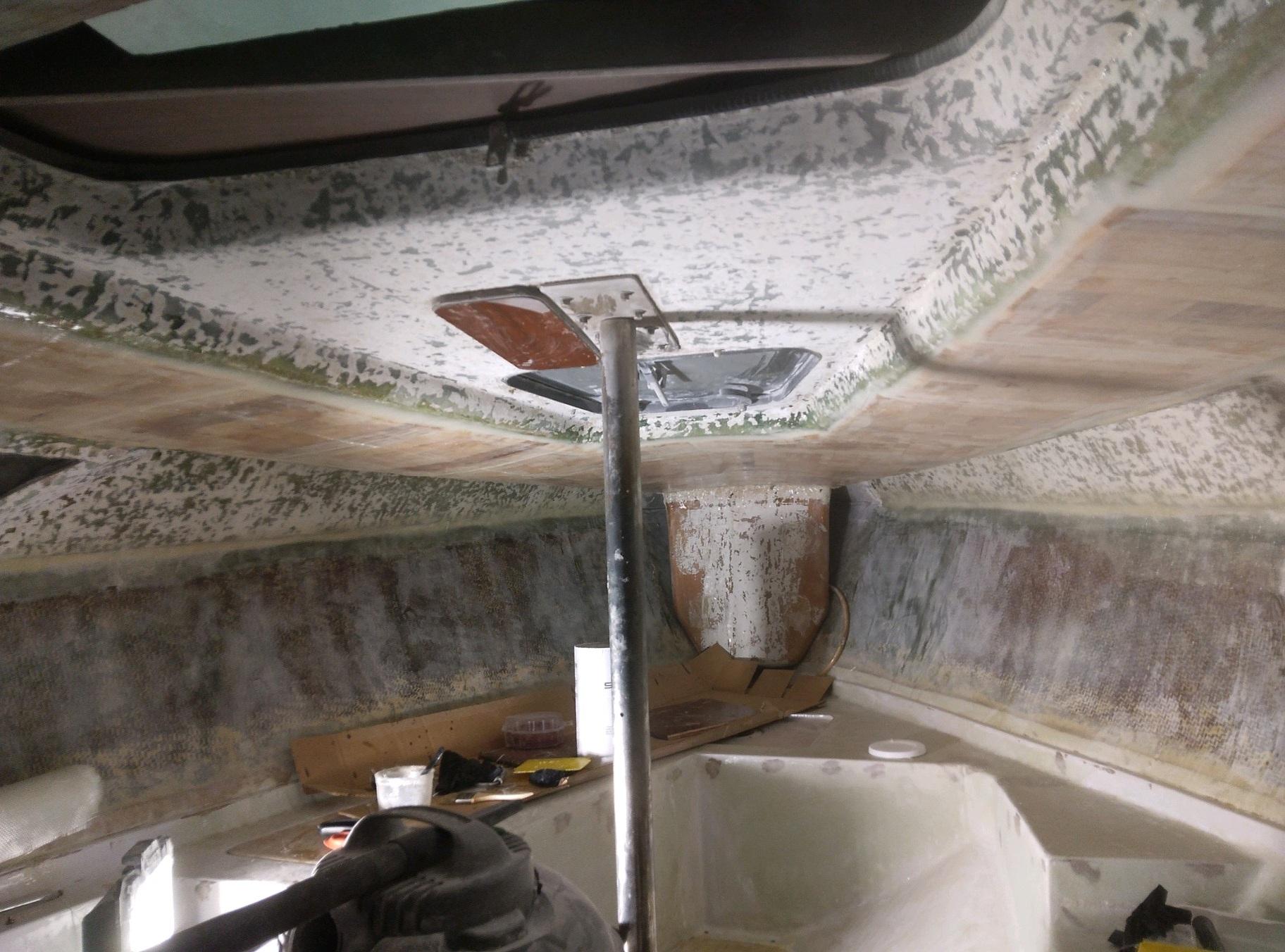

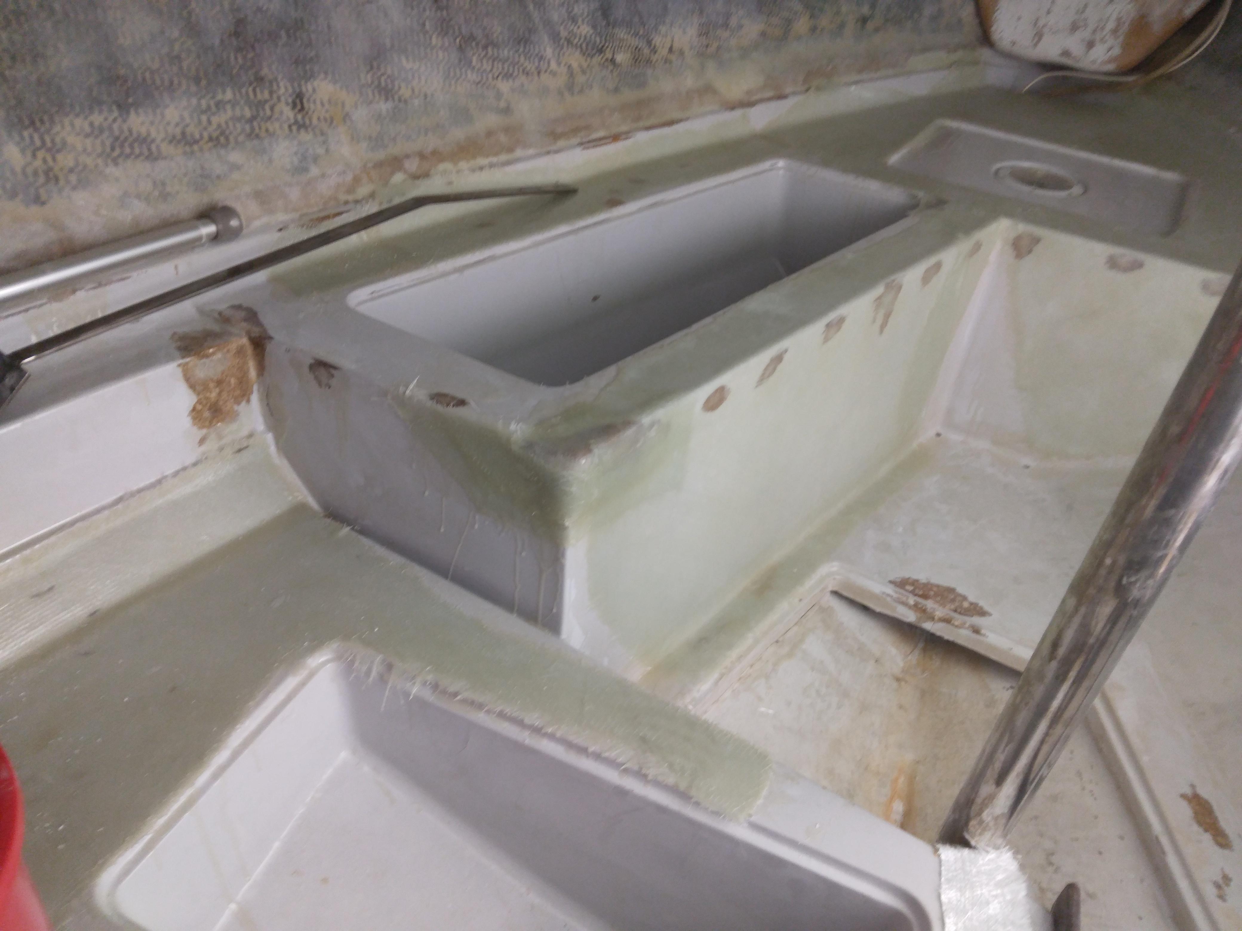

2 mars 2022 à 13 h 35 min #30447Updates! I have started to repair the interior cabin roof, as well as strengthen the molded cabin floors by adding additional glass.

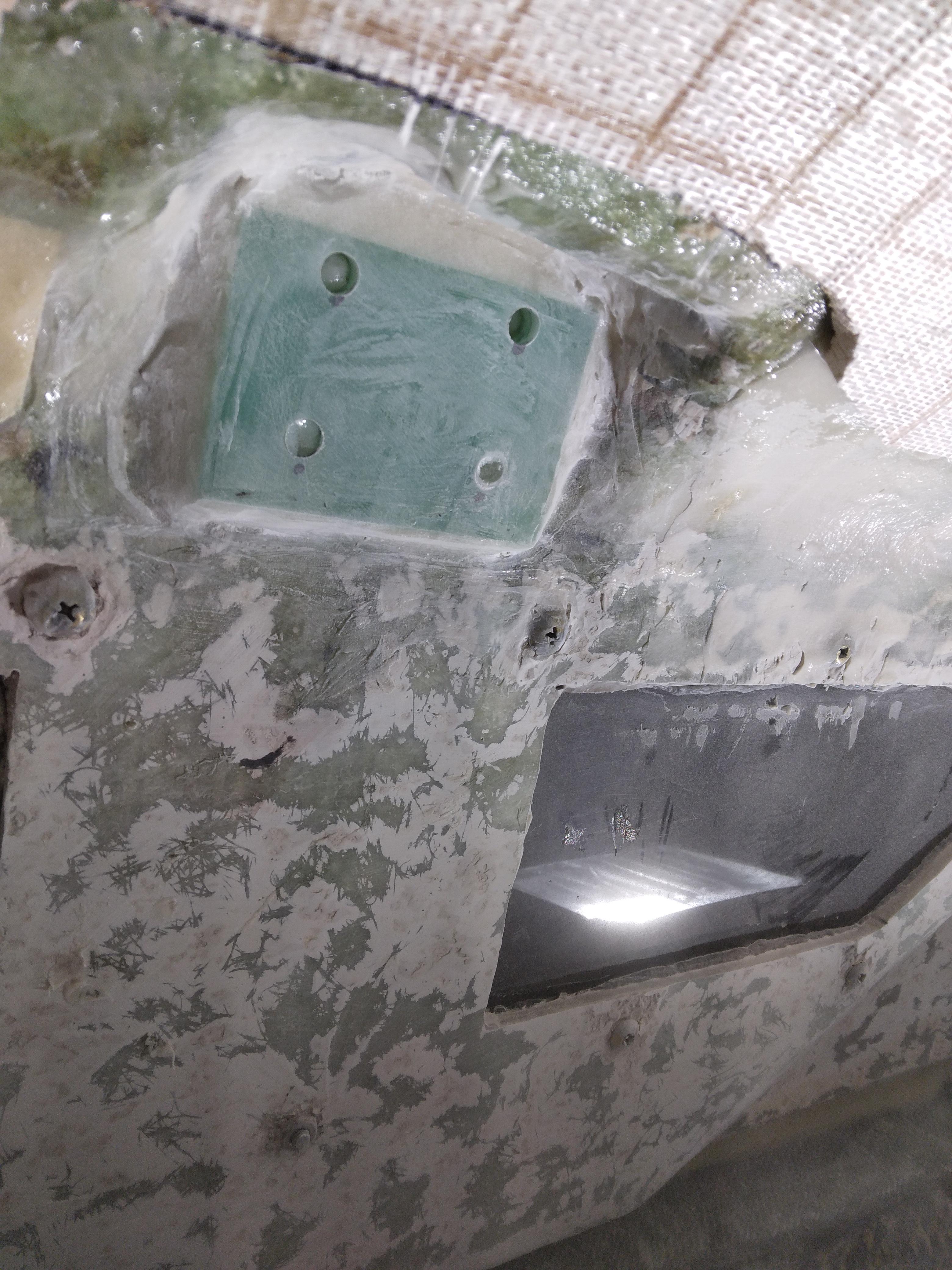

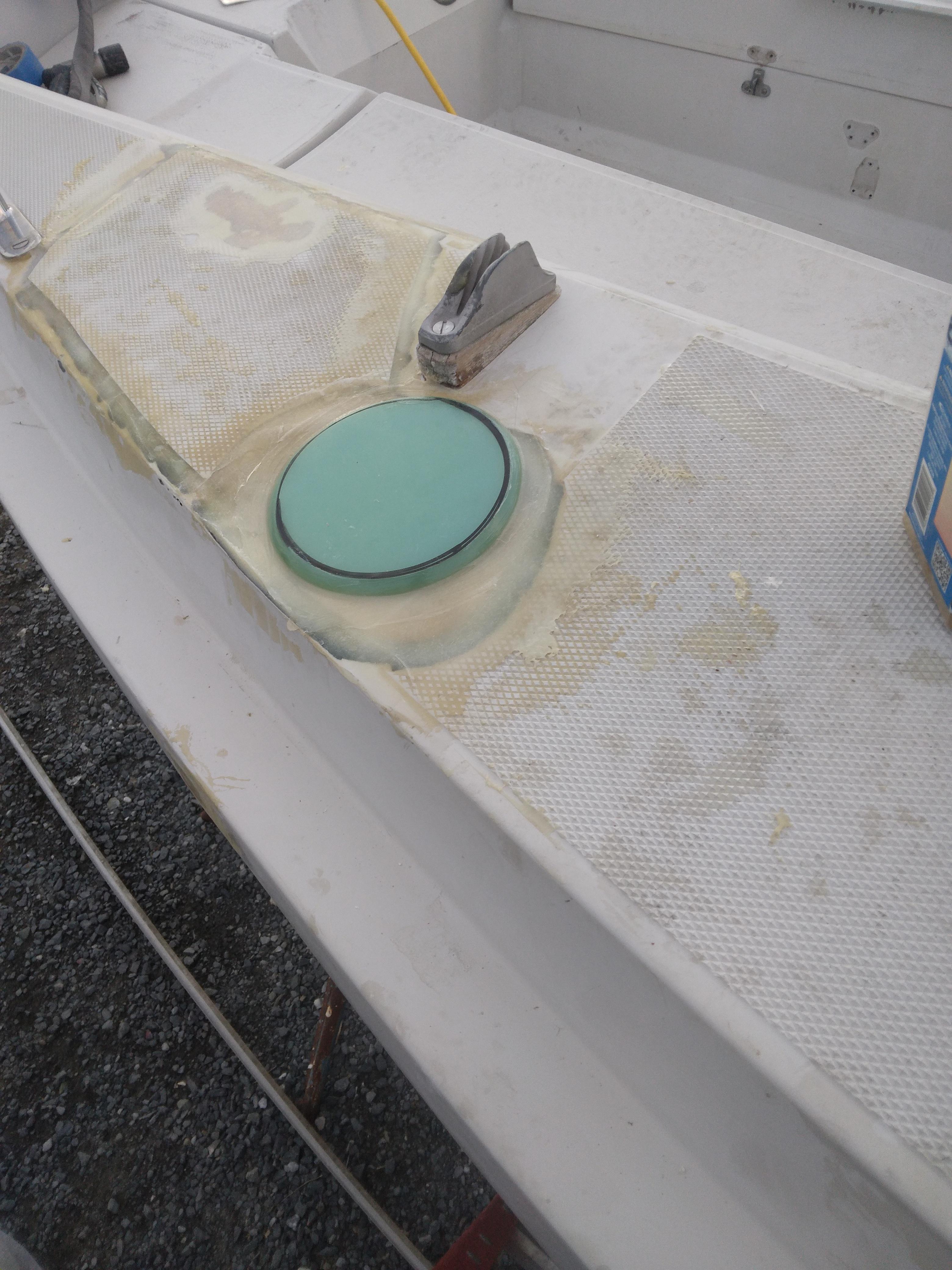

2 mars 2022 à 13 h 38 min #30449I also drilled out and filled the damaged screw holes that hold the teak rails on deck.
2 mars 2022 à 13 h 41 min #30450Using G10 fiberglass board, I created some mounting plates for the winches.

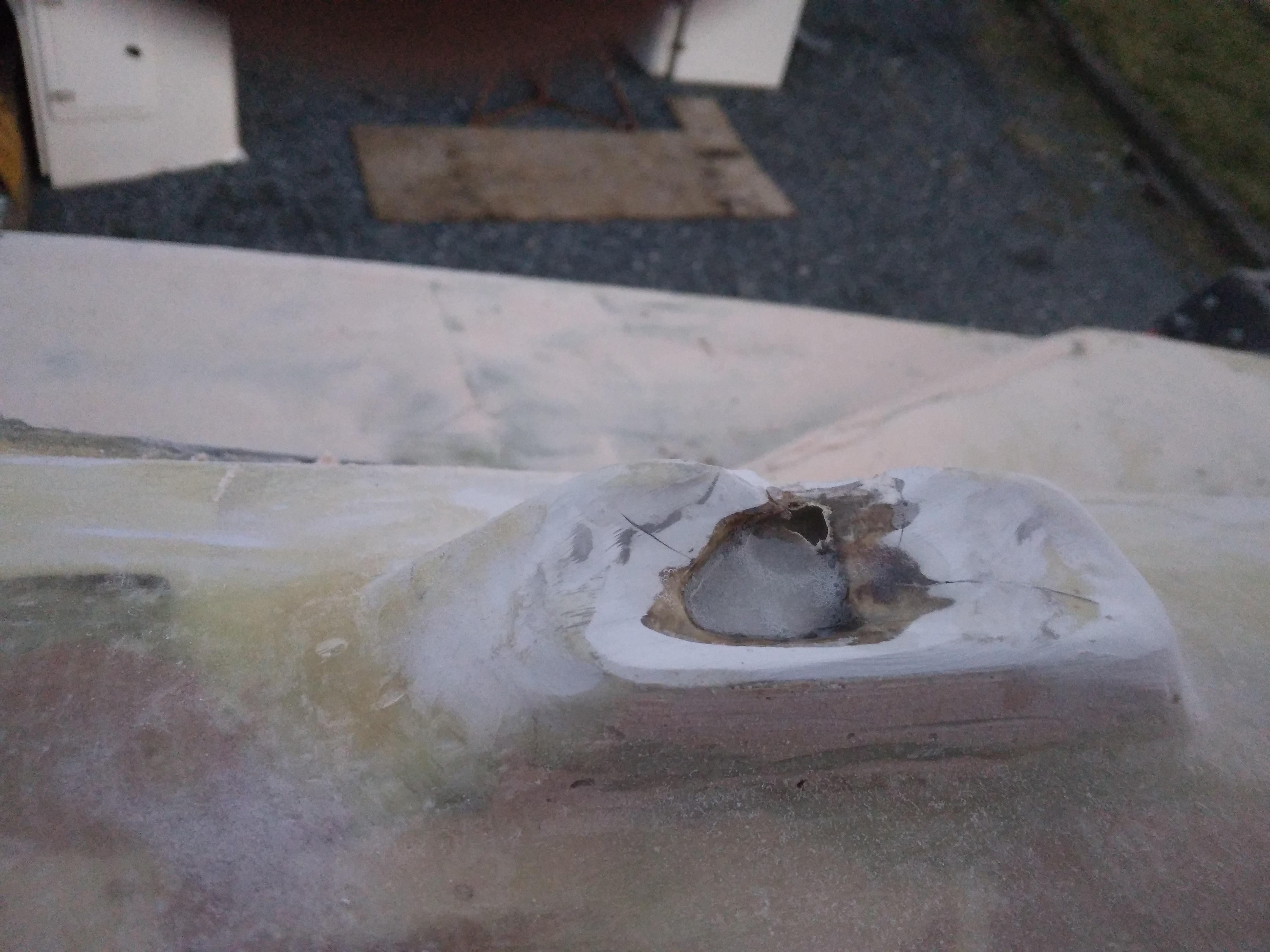

10 mars 2022 à 6 h 03 min #30494using smaller pieces of g10, I have strengthened the chain plates inside and out.
10 mars 2022 à 6 h 05 min #30495cabin roof
17 mars 2022 à 13 h 55 min #30521Last night I finished the first layer of glass over the balsa core roof!
today I sand it down and apply coat #2, and then it will be pretty much finished.

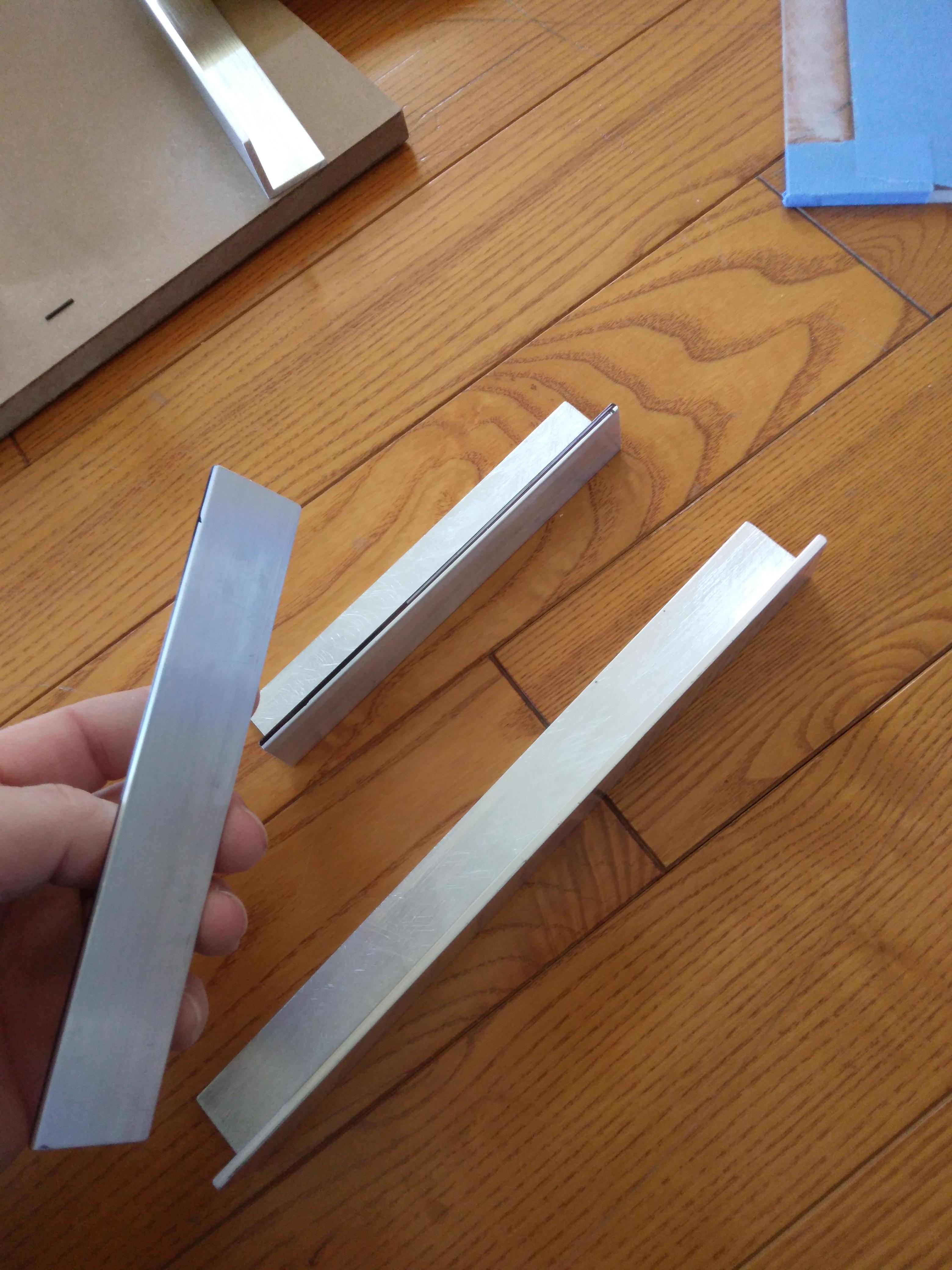

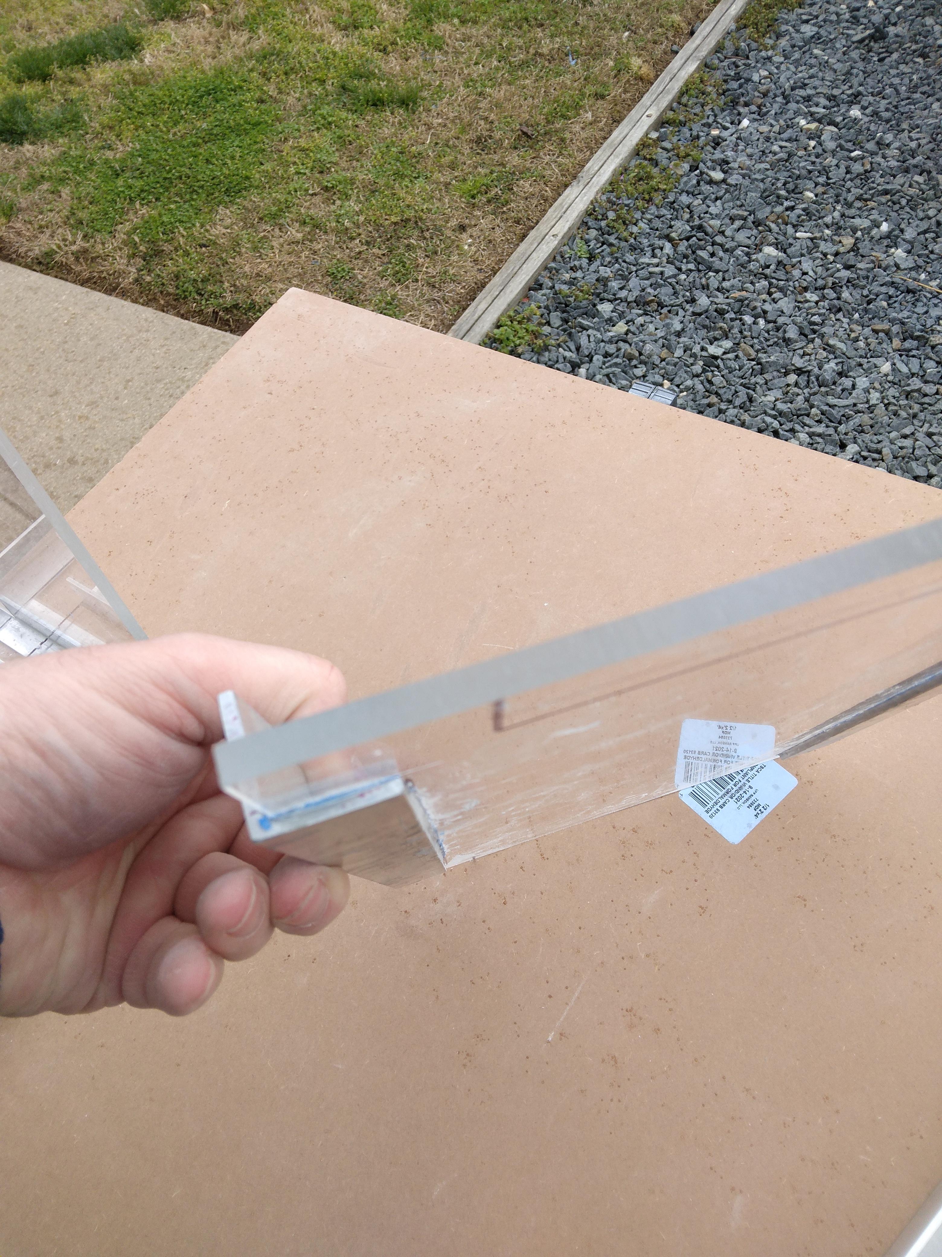

I also stepped on my phone… so I am waiting on a replacement! I have a couple of pics of my most recent project, a DIY battery box for some Lithium Ion Phosphate battery cells, which I built from 1/8″ thick by 1″ angled aluminum, 1/4″ acrylic. All held together with 1/4 » SS threaded rod, lock nuts and washers. I used 1/8″ copper bar for connectors for the negative terminal to the BMS (battery management system), and used 6, 8, and 2 AWG wires. I had to learn a lot about wiring, shrink wrap, etc. etc.!
I used thickened Epoxy to connect the aluminum to the acrylic, after scuffing them both up well with 80 grit sandpaper.
