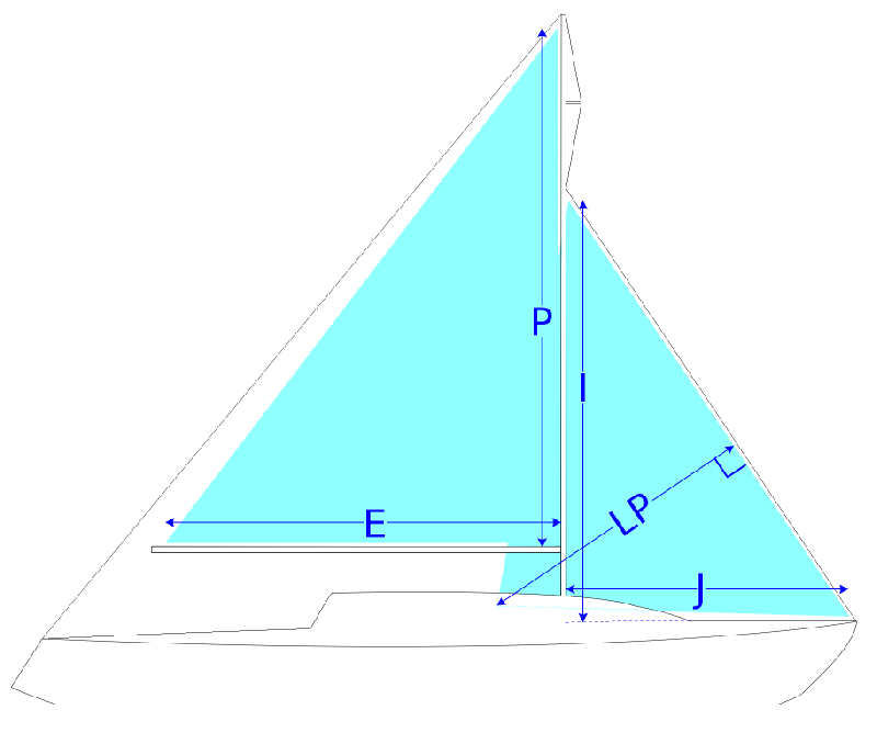

    Does anybody has the values for E P J I sail measurements of the Edel IV?
    I have these (but unconfirmed):
    E = 300 cm (boom)
    P = 700 cm (length of main sail)
    I = 830 cm (jib head to deck )
    J = 230 cm (mast to bow)
    Best regards

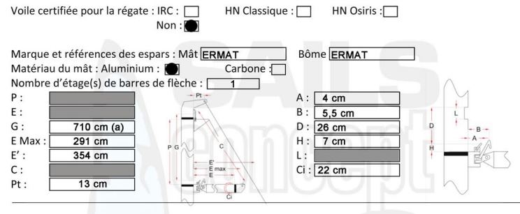

    I took measurement on my E4 2 years ago. This is my measurements
    Measurement in g permit me to sail with the roof open. I you don’t want to sail with the roof open you can add 15cm :)
    I hope it will help you
